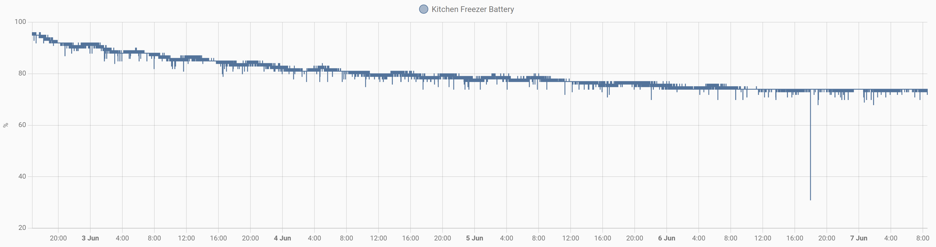

An additional question. The temperature measurement has 2 decimal digits, so a change is recognized even for a variation of 0,01°C.
Is there a way to setup a different triggering variation?
For info, I’m currently doing a test of your unit as part of a bigger project to monitor a set of freezer.
I integrated your product into Home Assistant using a standard BT integration, so the Engbird is never active unless I need a configuration change.
I’ll try to attach to this message a graph of the battery consumption since installation that will also show the huge amount of reading done at the moment.
Thanks for your attention and I hope you’ll help me to successfully complete the test
Giacomo
The interval time setting will have a little impact on the power. But the bigger impact is the behaviour of the IBS-TH2 staying connected to the app via Bluetooth at all times and the app reading the IBS-TH2’s historical data.
Sorry, triggering variation cannot be changed.
