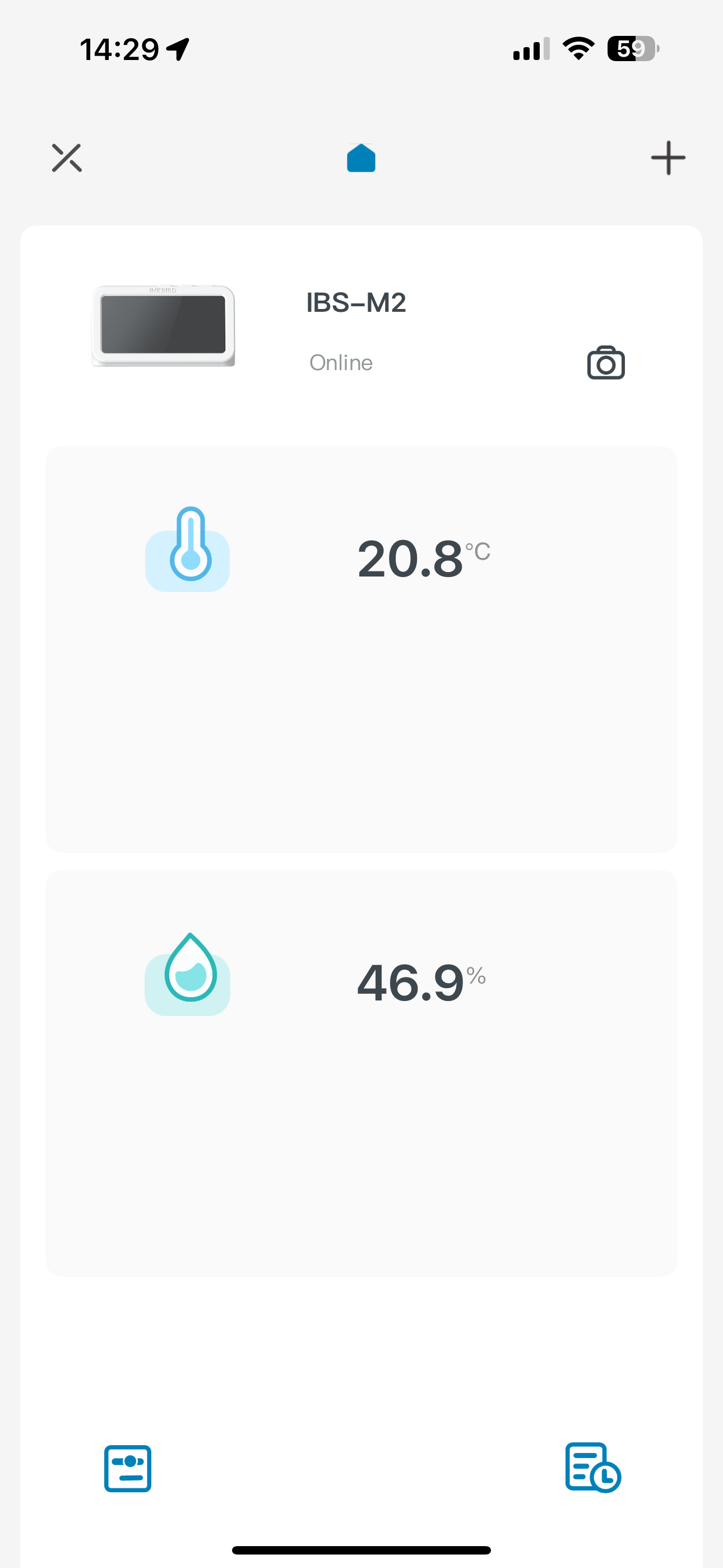

via INKBIRD app → IBS-M2 settings page → ‘+’ on the top right corner. Screenshot attached.
Which just searches then stops after 60 secs.

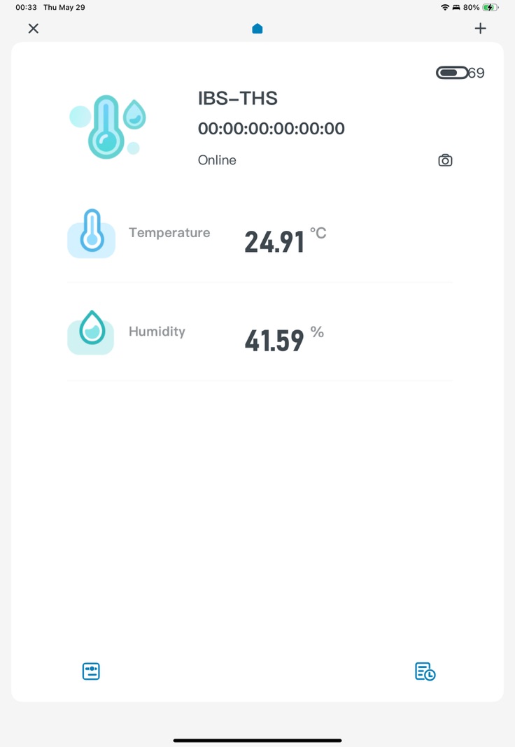

Yes when trying add from the app home page I can elect IBS-TH and
all the IBS-TH1 do show up on the search. They can be connected but only one at a time as each one replaces the prior. I notice that the App does not read their Mac address and thus I suspect think they are all the same sensor. Screenshots are attached.
