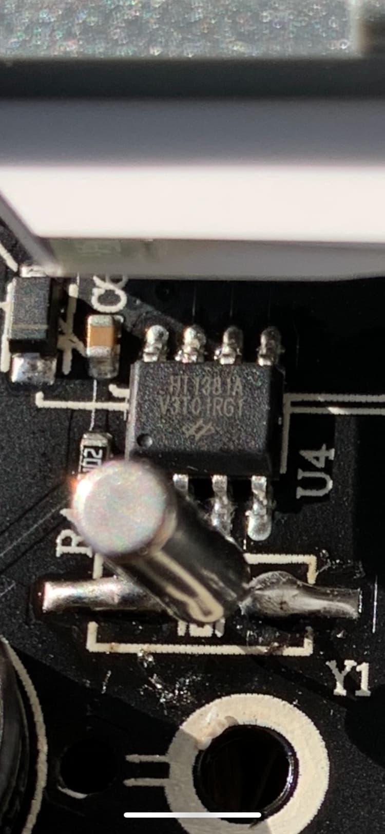

Hi i also have the same issue time error… after asking fo repair i got answer that the company policy was to not share any data or scematics… as i am a electronic design engineer after i open the unit i imediatly notice a fatal desing error the time keeper ic HT1381 oscilator have no compensation capacitors and the clock is not good and stable so the communication with microcontroller fails i mesure with the scope meter.. after i put 2 8pf capacitors as described in datasheet of the time keeper ic the unit star to work as it should… soo guys the problem is in the design… and the solution is very easy for repair…

Now i do not have a picture i need to open the unit again for take the picture… but is easy like the picture i post show, you need to connect a capacitor on each cristal oscilator pin and ground..I remove the solder mask on pcb and connect the capacitors directtly to the oscilator pins and ground…
this is how the cristal looks like and is just near the HT1381 timekeeper ic

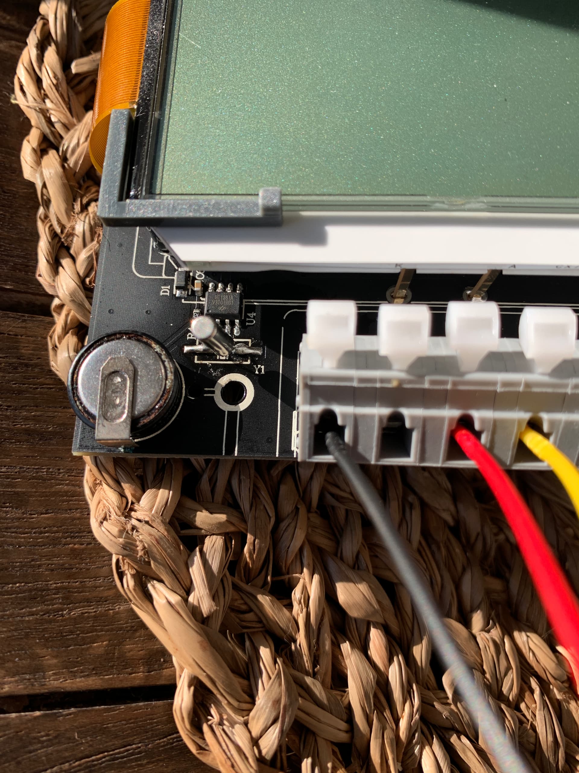

Hi Role, Can you share photos of the “repaired” one? Where can I buy the 8pf capacitors? We are not engineers but very keen to try out…

Capacitor spec 1206 8PF 5% 50V NPO Is this ok?
The attached photos will help you understand the challenge in soldering a 8 pfd cap between U4 pin 2 and 4 GND and second cap between pin 3 and 4 GND.
While it is easier to connect to the crystal legs it is not recommended hence the reference to solder to the IC legs.

For the 8pf capacitor, which type specifically should we get…as attached, there is ceramic capacitor and others are in “uF” measurement with voltage specification.
Yes The small ceramic capacitors.
Try to connect with as short legs as you can manage.

Excuse my ignorance but what exactly is going on in the photo please? Have you replaced anything or just showing the location?
